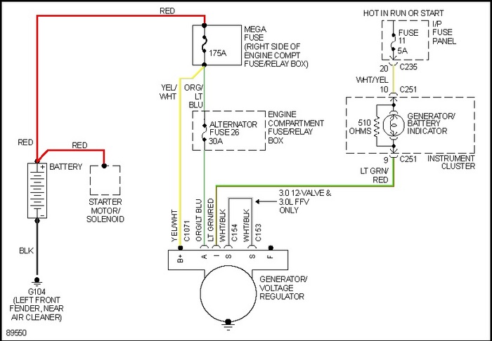

Charging system wiring, below.

Yes, that indicates the charging system is at fault.

There may be a problem with indicator lite or wiring. The info shows a resistor to bypass the lite incase the lite-bulb vibrates out socket, or goes out. Does the charge lite on the dash work?
I've seen diagrams like this before, with the bypass, generator would not charge unless lite was fixed.

OLDHAMD
The light does not come on. It came on originally when I had low voltage on the bad alternator. I replaced the alternator and the light went out. I assumed it was because I fixed the problem. According to the owners manual the light should come on briefly when the key is turned to the on position. It does not! Is there a fuse I should be looking for to replace?

JDL
  • 16,098 POSTS
The fuse is in the diagram, goes hot/voltage with key on. If fuse is ok, use voltage tester at fuse leg, where the fuse plugs in.

OLDHAMD
You are the man! Replaced the fuse and alternator is charging the battery to 14.25 v

KHLOW2008
  • 41,814 POSTS
The Orange/Light Blue wire should have battery voltage. With engine off, unplug the alternator and test the Orange/Light Blue wire. If voltage is not avaliable or not battery voltage, check the voltage at alternator fuse # 26 in engine compartment fuse and relay box.
If battery voltage is available, check for poor continuity between fuse and alternator.
Try applying battery voltage to Orange/Light Blue wire and test if charging is as desired.
