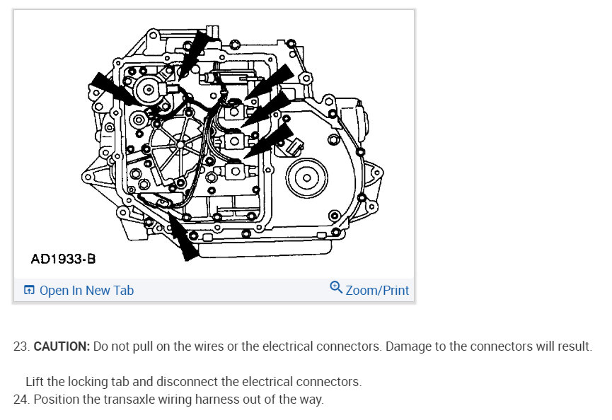

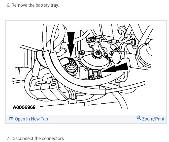

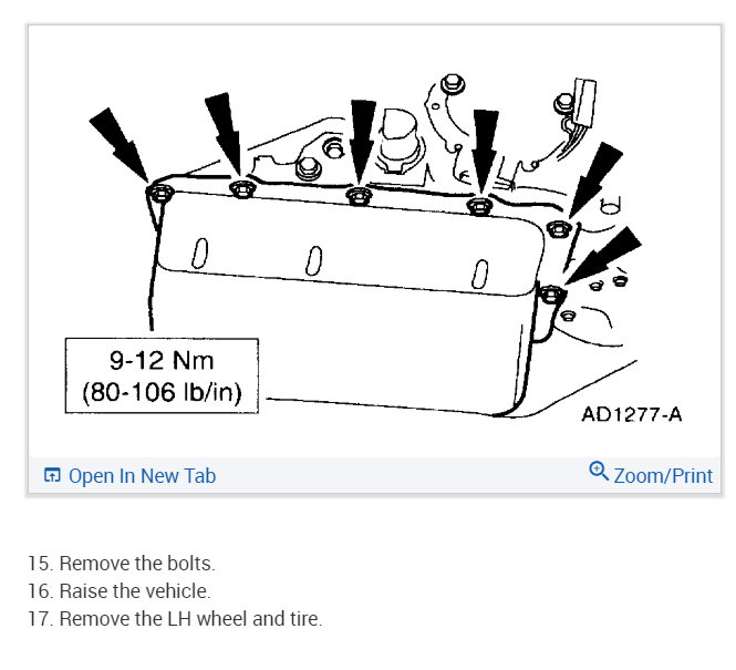

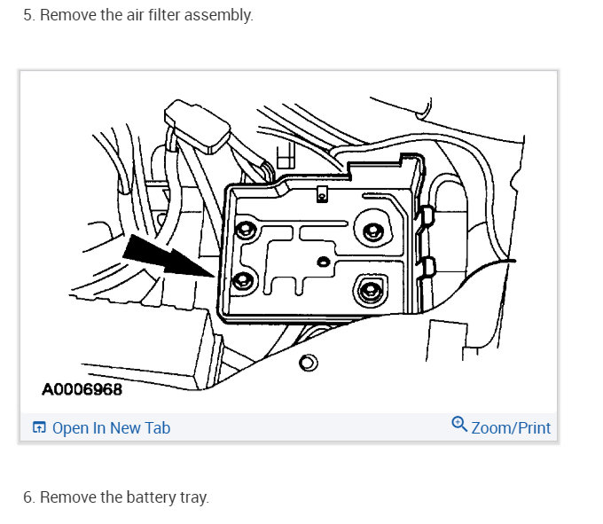

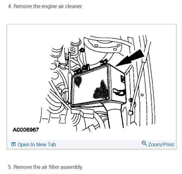

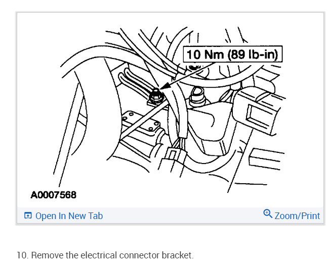

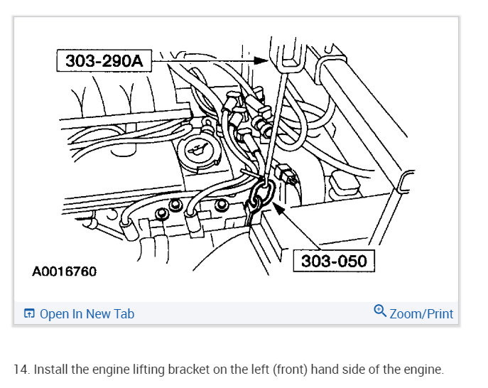

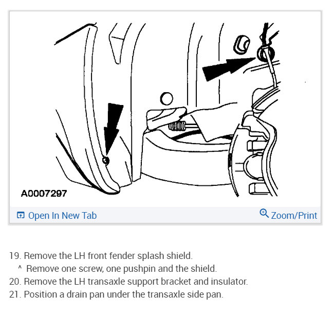

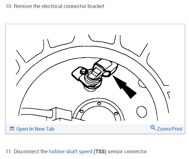

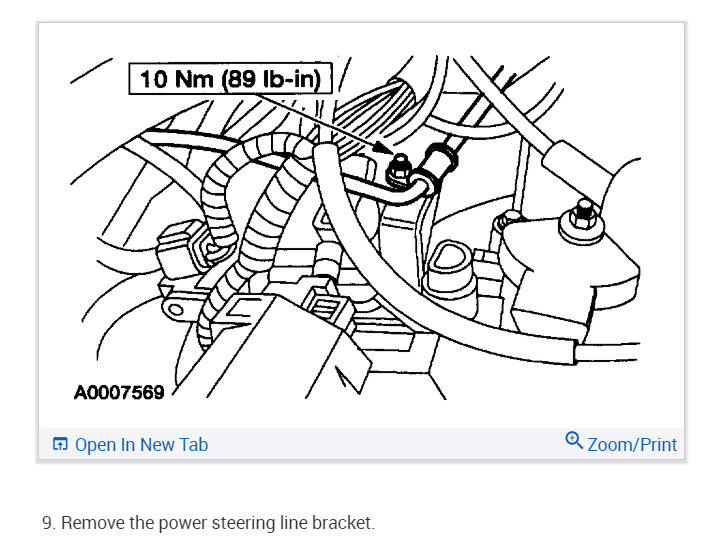

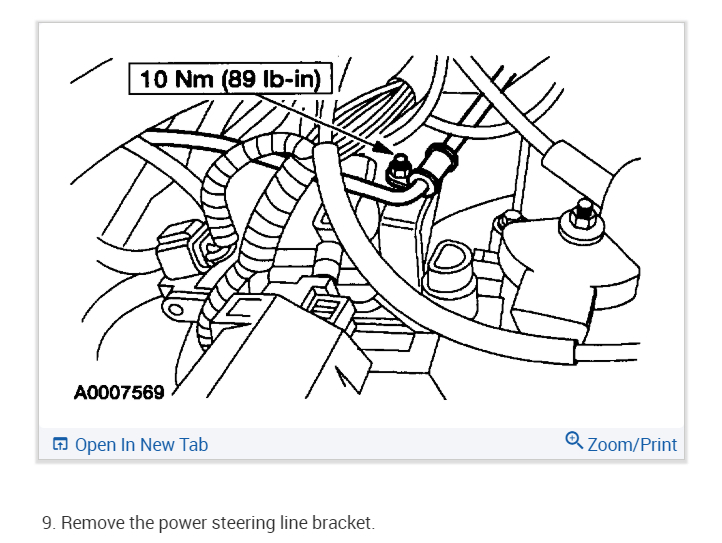

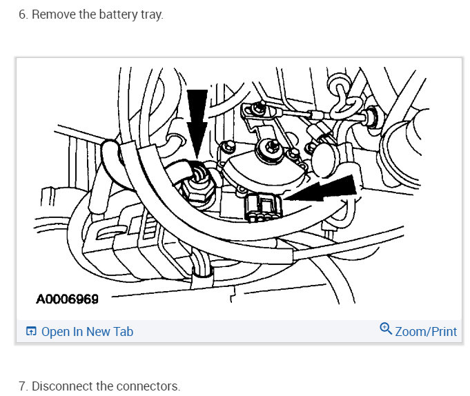

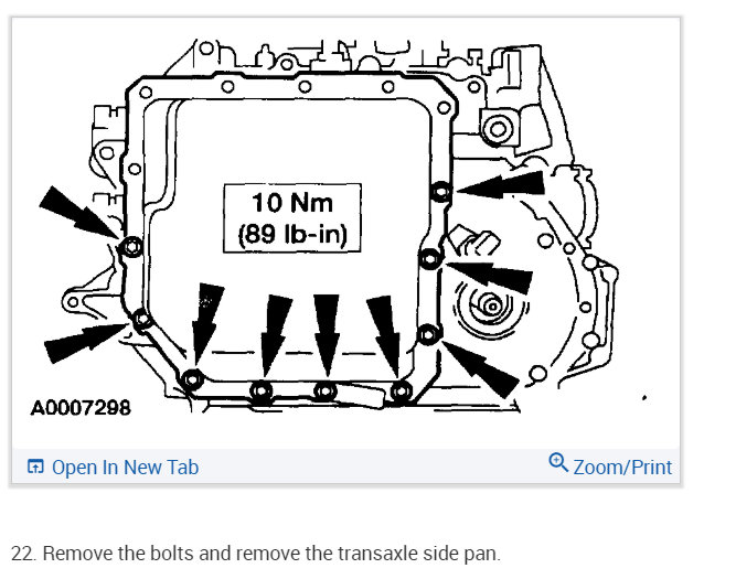

The transmission had been working fine until yesterday. While accelerating from a stop I had only reached about 10 mph when suddenly the transmission disengaged. I coasted into a parking lot and the transmission acted as if it were in neutral. After I came to a stop I tried reverse & overdrive, drive & first but the transmission was like it was in neutral.

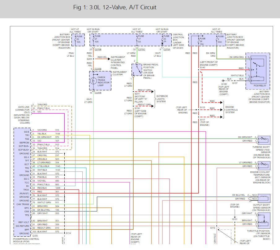

I pulled the codes and this is what I got: Freeze frame was P0750 at 777 rpm.
I also retrieved other codes P1747, P0743, P0750, P0760 and P1451. I checked all the fuses and they were fine. I switch the PCM relay with the Fan relay & still neutral. Can I fix this myself by changing the Shift solenoid A, or is it in the transmission and not accessible. Does the transmission need to be overhauled.

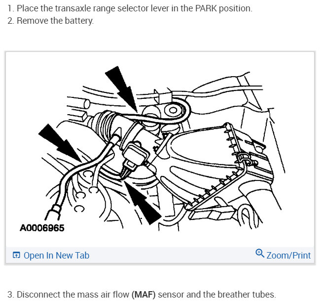

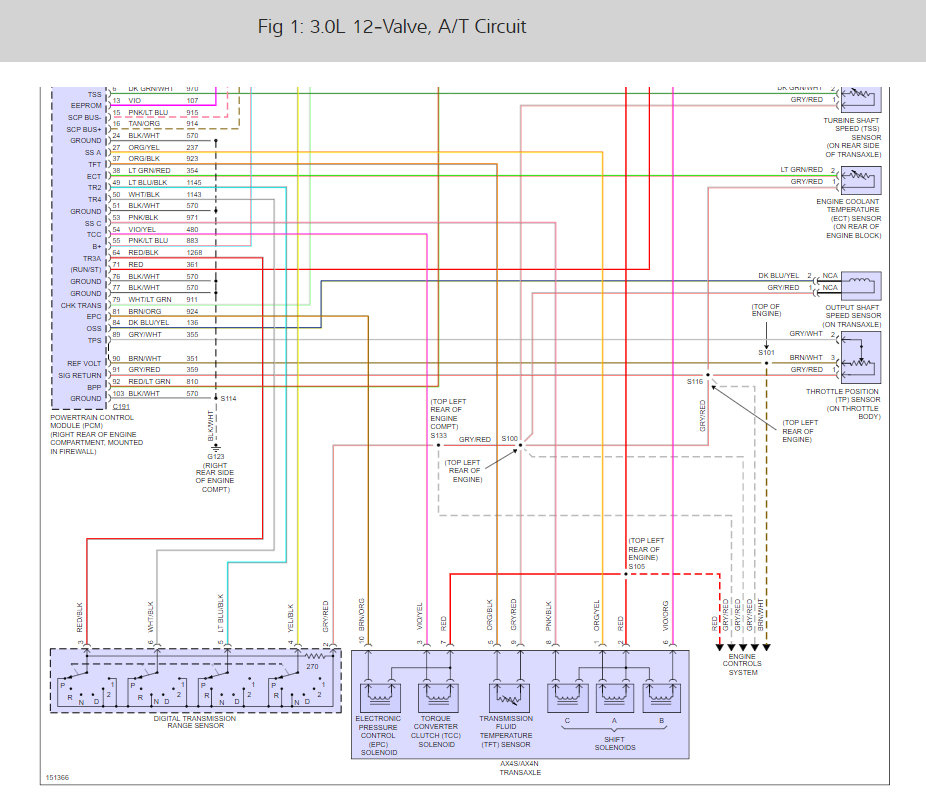

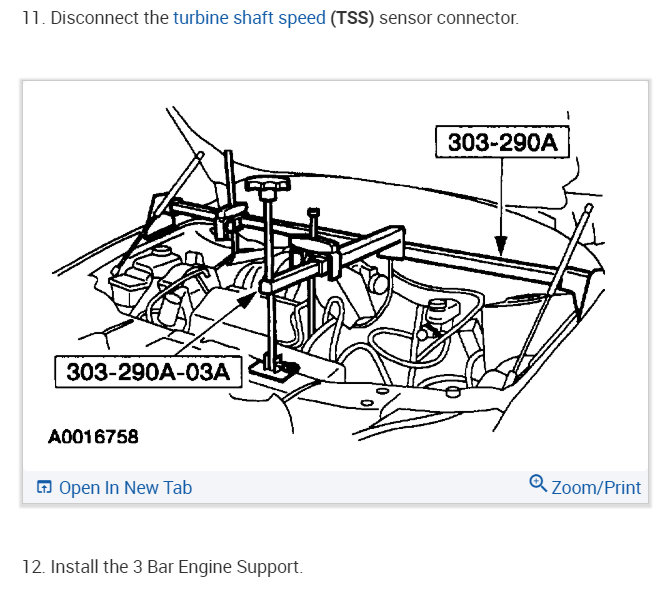

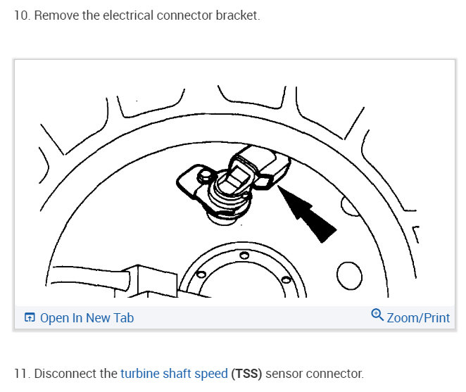

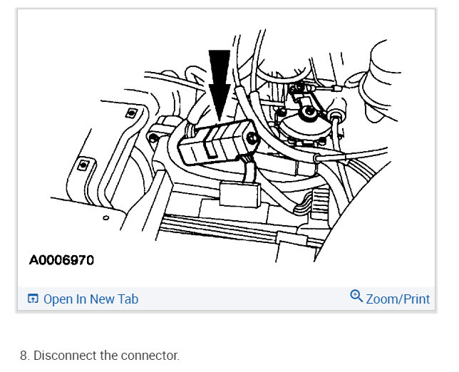

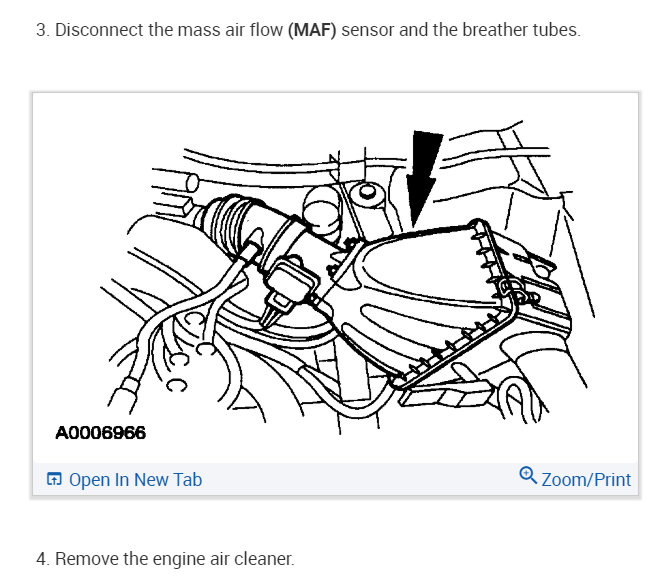

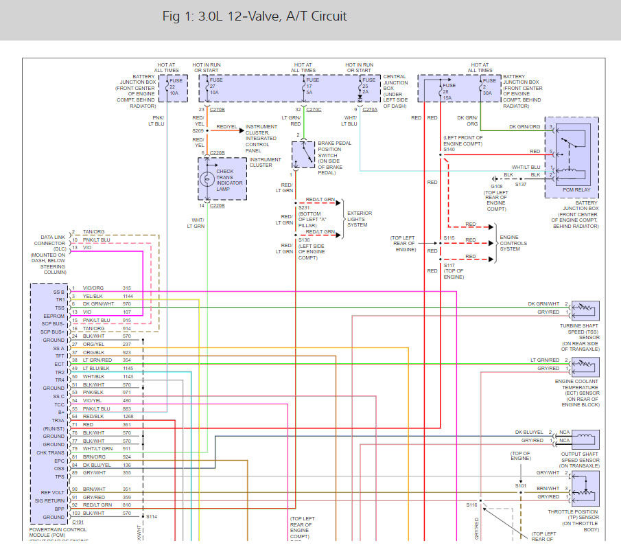

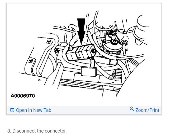

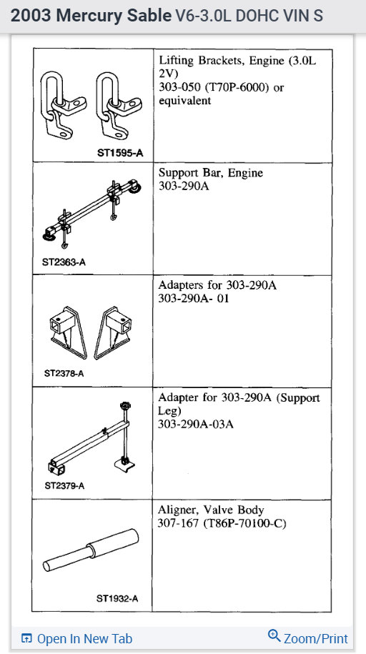

The shift solenoids go out all the time here are diagrams below to show you how to change it out. Then clear the codes you should be good to go. Here are the wiring diagrams as well so you can see which solenoid is which.
Check out the diagrams (Below). Let us know what happens and please upload pictures or videos of the problem.

Thank you so much for this guide worked great I got a new solenoid for $56.00 car works great once again!

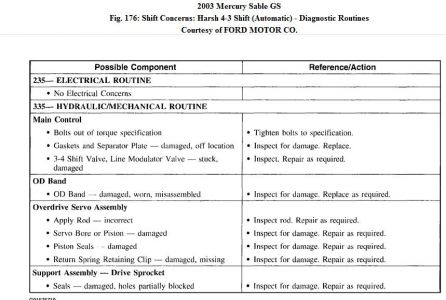

on a light pull (medium upgrade ) at 35-40 mph , light throttle , when trans is allowed to downshift by itself (no increase in throttle ) , there may be several hard attempted shifts before it gets down into third. Kicking it down causes a normal smooth downshift . Manually shifting down is also normal . The abnormal shift feels like a band or clutch is not fully locking up.
