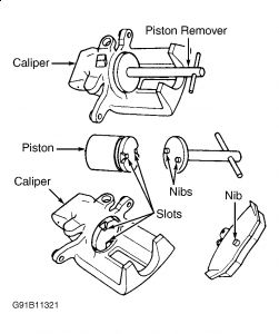

I'm having a hard time doing a rear brake pad replacement can't get the cylinder on the caliber to move I have a box like tool sold to do this but how do I get it to move

Caliper piston must be properly retracted.
Using Piston Remover/Installer (T87P-2588-A), rotate piston clockwise until piston is fully seated.
Ensure one slot in piston face is positioned so it will engage nib on brake pad
https://www.2carpros.com/forum/automotive_pictures/99387_Graphic1_648.jpg
