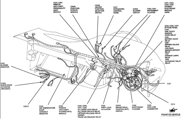

Electrical problem 6 cyl Front Wheel Drive Automatic 140000 miles
I've read through my so called owners manual for this car and cannot find the turn signal flasher location. Where is it located on the '98 Sable?
Sep 12, 2008 at 1:47 PM
  • 54,897 POSTS

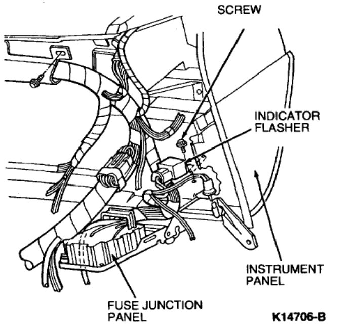

The turn signal flasher is located on the driver's side under dash by the footwell.
Here are the instructions and location of the flasher unit so you can change it out. (below)

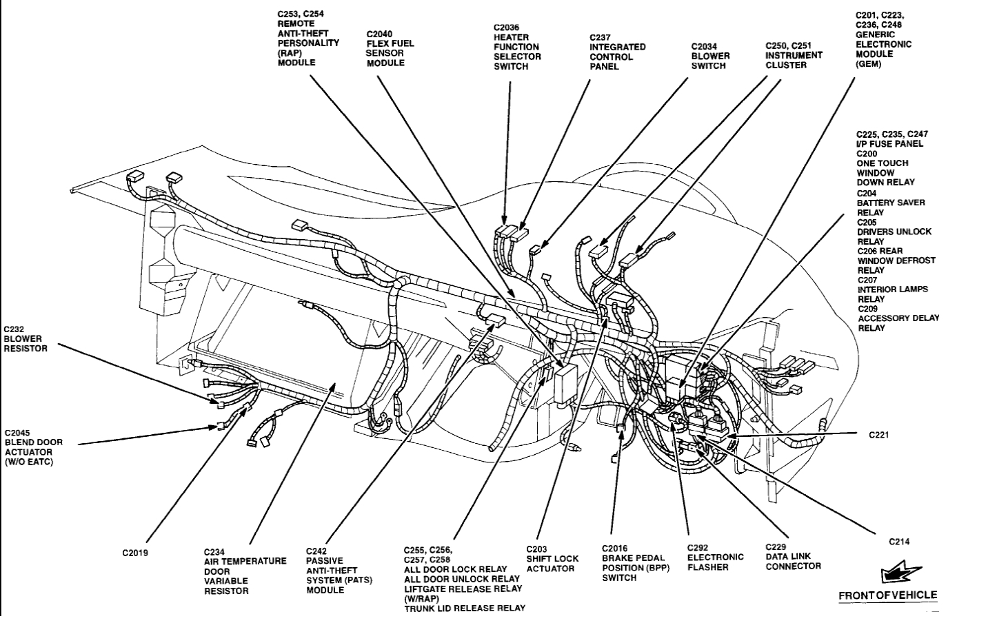

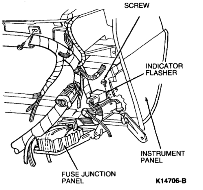

My signals work only when the 4 way flasher is pushed in, the four way flasher when out doesnt work, fuses look good, is there any thing else i can look at to see if it is the problem before i rip the steering column apart..
Oct 7, 2020 at 5:16 AM (Merged)
BLUELIGHTNIN6
  • 16,542 POSTS
Inspect your flasher before going into the steering column..It is located under the left side of dash, pictured below..

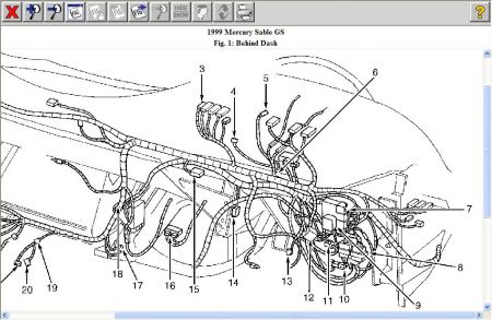

where is the flasher unit located? This for turn signals.
  • 75,992 POSTS
The electronic flasher is located at no.11 see below

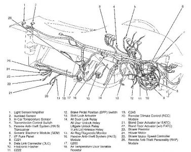

The turn signals will not work,hazard flashers work fine. Could you tell me where the flasher is located for the turn signals,and what it might look like?Also if this is not the problem, just what I might look for.
If the stalk is bad how do I tell ?
Thanks so much
BMRFIXIT
  • 19,053 POSTS
Flasher relay would be 1st to replace its located Behind left side of dash, above fuse block good luck
