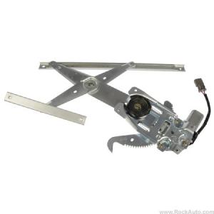

Just started. I hear a clicking sound in front when I press the window button. The sound doesn't happen when I press the other windows.

AND WINDOW WILL NOT OPERATE !!
POSSIBLE WINDOW REGULATOR
REMOVE DOOR PANEL AND CHECK MOUNTED SCREWS

if its making clicking usually its a regulator
please be clear when ask your question so we can and try to answer to the best we can
you have the car we try to diagnose according to your description
since you changed your description to the matter
and all not working or only one working, start your check with the driver door jam, wiring harness

Thanks. The one click occurs in front by steering wheel each time I try to operate. For some reason, the back windows started working again
open driver door and twist and check the wiring harness in the door jam
