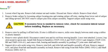

I have a 1992 Mecury Savle GS 3.0 My left front wheel vearing is bad i have the tire, caliper, rotor off. I appears i need a pully to pull of and to put back on. Can i get instruction and diagrams to instruct on how to do this?

https://images.2carpros.com/forum/automotive_pictures/261618_Noname_2642.jpg
https://images.2carpros.com/forum/automotive_pictures/261618_Noname2_862.jpg
