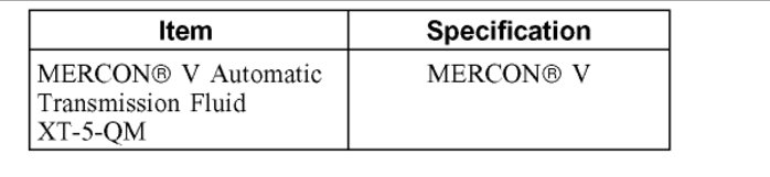

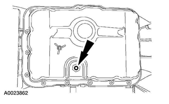

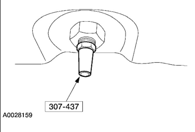

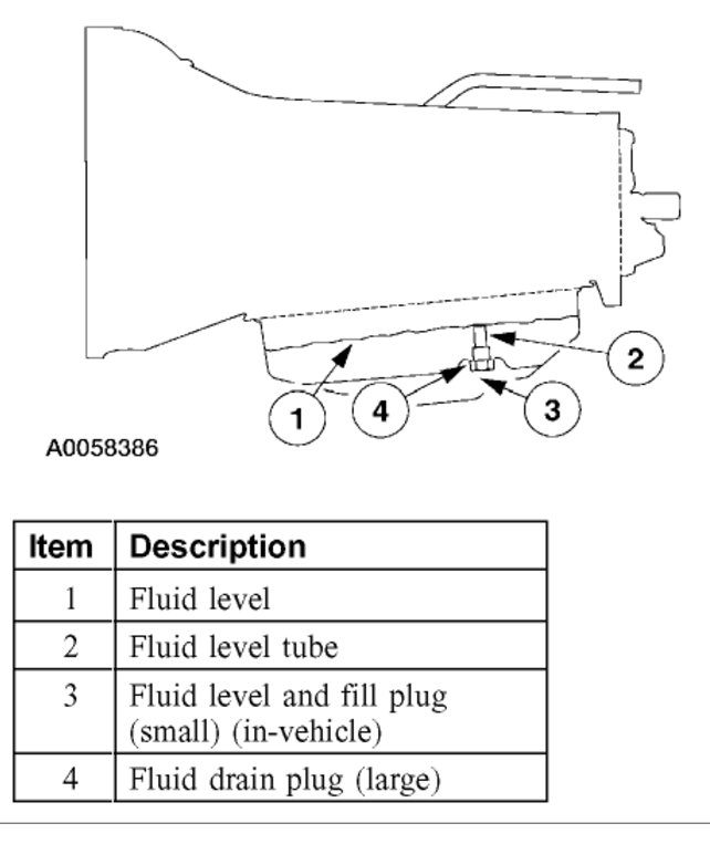

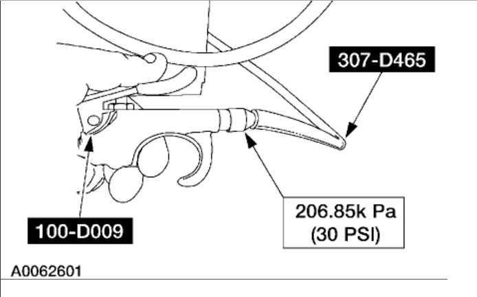

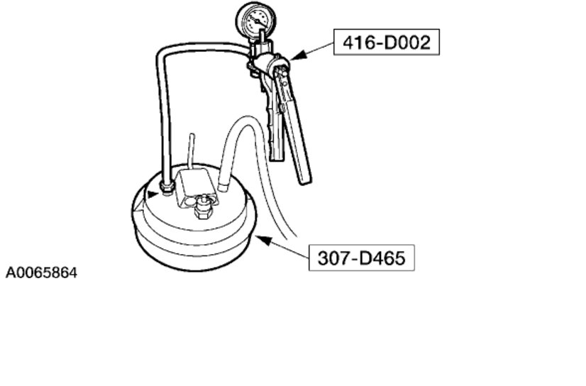

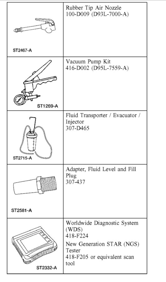

2004 MERCURY MOUNTAINEER

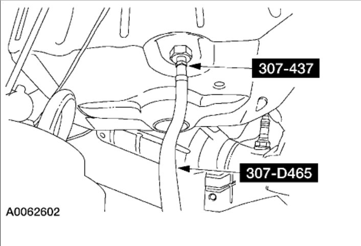

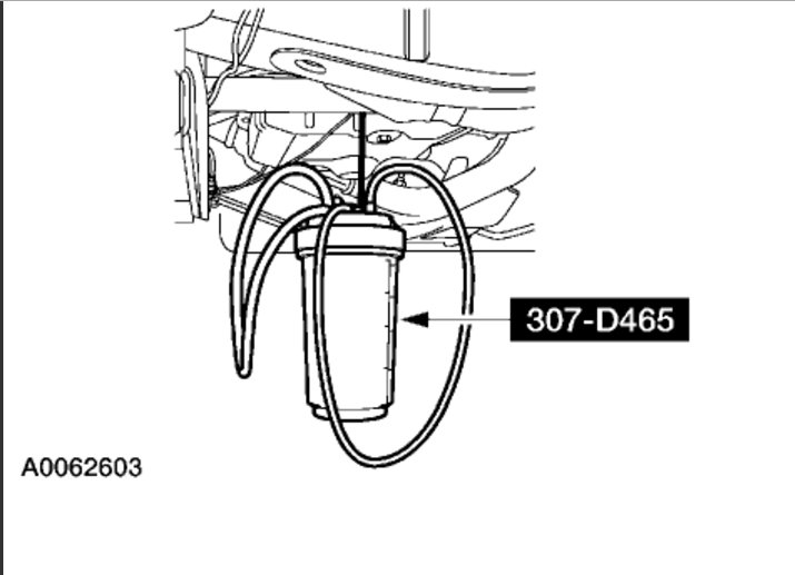

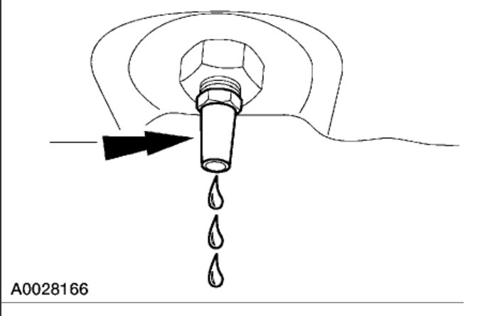

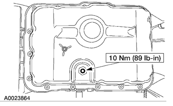

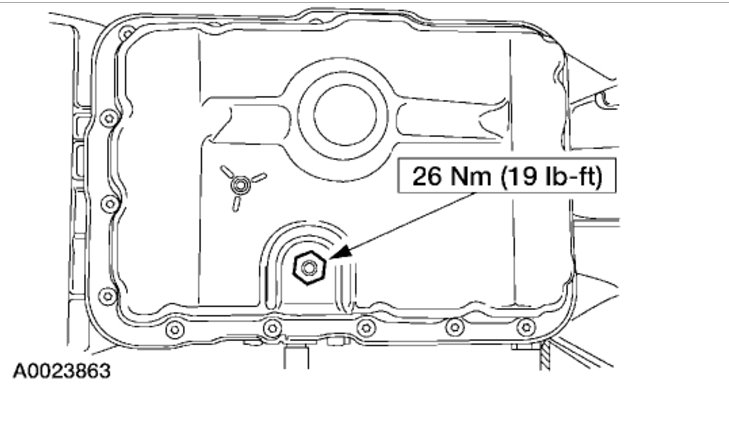

Where is the transmission dipstick located?
Monday, December 21st, 2009 AT 7:45 PM
MECHANIC
110,192 POSTS
These do not have a dipsticks here is how you check or add fluid instructions in the diagrams below. Check out the diagrams (Below). Please let us know if you need anything else to get the problem fixed.
