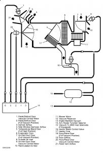

The check engine light is on and a check of the code says its a vacuum problem. How can I get a diagram of the vacuum lines for this engine?
Saturday, November 14th, 2009 AT 11:06 AM
6 Replies
OBXAUTOMEDIC
  • 3,711 POSTS
Hi Greg,
this guide should help you
Here is the vacuum diagram....
https://www.2carpros.com/forum/automotive_pictures/188069_99mountvac_1.jpg
