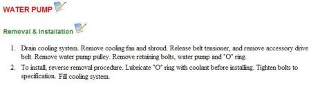

can a normal person with limited knowledge and tools change a water pump on a 97 grand marquis?

Just read over the steps below and see if you think you can handle the repairs alone.
