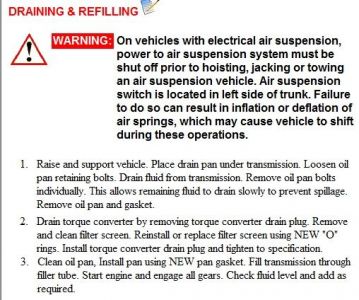

How do I properly drain and refill transmission fluid in a 1997 Mercury Grand Marquis?

Yes you helped.
Thanks!
