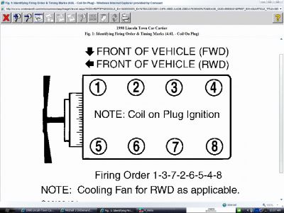

I'm trying to locate the Premium Oxygen Sensor, the computer code was P1151. I believe it is the sensor closest to the engine.

https://www.2carpros.com/forum/automotive_pictures/62217_Firing_Order_4.jpg
It's the one closest to the engine, on the side with #5 cylinder...
