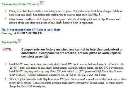

Can anyone give me some details on how to change the passenger cv joint boot on my 2000 cougar please? I like to do things myself, so i'd really appreciate it if someone could help me out.

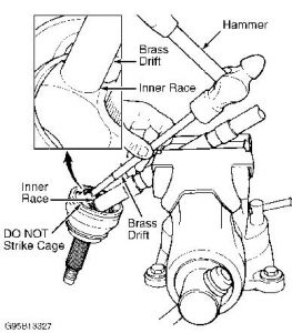

Info you requested is below. Let me know if you need any more assistance.
https://www.2carpros.com/forum/automotive_pictures/261618_Noname_95.jpg
FIGURE 3
https://www.2carpros.com/forum/automotive_pictures/261618_fig_2.jpg
Hope this helps..

Yes, it helps very much. This information should help just fine. I will be using this site more often in the future.
