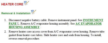

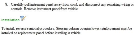

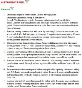

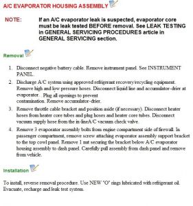

I need to replace the heater core in a 1994 Mercury Cougar and need a visual aide to doso. Can you help?
Friday, March 26th, 2010 AT 8:17 PM
BLUELIGHTNIN6
MECHANIC
16,542 POSTS
See if this step-by-step helps any...
