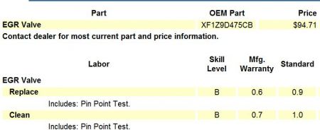

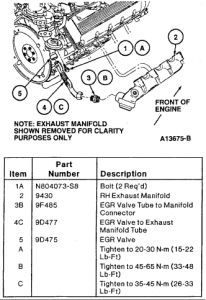

What does an EGR valve look like? How much do they cost?

EGR Component Location
Note:Part and labor varies within location.
