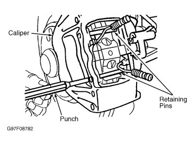

Trying to replace the pads in the front and they are dissimilar to other vehicles I have done the brakes on. Help!

Sounds like you have the fixed caliper? Use a punch to remove the pins that retain the pads, first remove the clips that hold the pins!
Raise vehicle and support. Remove wheels. Disconnect brake pad wear indicator sensor (if equipped). Using a punch, remove retaining pins for brake pads. Remove spring clip. Remove brake pads.
Replace brake pad wear indicator sensor if insulation layer on contact plate is worn through or if sensor or wiring are damaged. Before installing new pads, press pistons into caliper. If caliper has 4 pistons, wedge 2 pistons while pressing 2 remaining pistons back.
To complete installation, reverse removal procedure. If caliper was removed, replace caliper retaining bolts. Before driving, pump brake pedal slowly until brake pads contact rotors.
