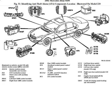

When I set my alarm with my remote, the alarm automatically goe's off with lights flashing. When I dis-arm and re-arm with my remote, the alarm automatically goe's off again with the lights flash. Each time I arm the alarm system, this hapens. This is a factory alarm. I don't mine donating but lets see how it work first

There are numerous reasons for the alarm to trigger by itself .. could be a bad sensor/door switch etc, etc. .. I would have the vehicle plugged into a diagnostic computer to check for alarm fault codes stored on the cars PCM (computer)
https://www.2carpros.com/forum/automotive_pictures/266999_merc_6.jpg

I did go to a Mercedes shop today 2/25/10 and they found that my R&R PSE Pump (pump that open and close the trunk and doors) had some type of internal leaks which cause the computer to re act as if a door or the trunk was open causing the lights to flash.
