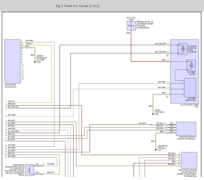

I'M TOLD THAT I HAVE A BAD BLOWER RELAY PART NUMBER BEHR90341GKR I NEED TO KNOW WHERE IT'S LOCATED IN MY CAR. THANKS IN ADVANCE FOR ANY HELP YOU CAN OFFER. THE BLOWER MOTOR DOES NOT WORK AT ALL SO PERHAPS I WAS WRONG ON THE NAME OF THE PART. LETS GO WITH THE LOCATION OF THE RESISTOR, OR SWITCH AS I THINK THAT'S PROBABLY MY PROBLEM. THANKS AGAIN FOR YOUR HELP. DEACO

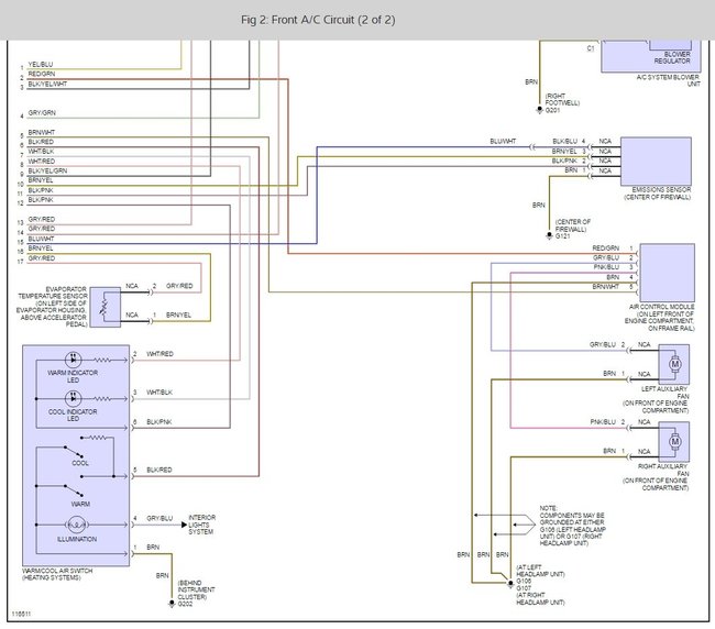

Hey Deaco,
There is no resistor, but there is a speed control module which is right next tot he blower motor. here is a wiring diagram that show you how the circuit is routed out and a guide that will help you test for the problem and get it fixed.
Please run some tests and get back to us so we can continue helping you.
Best, Ken
