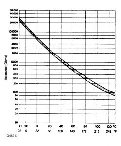

Generally, if it happens at the AM startup and then it'sOK, the Coolant temp sensor test this way...
CIS-E SYSTEM -1988 Mercedes-Benz 300E
Page 1 of 1
Code 3, Coolant Temperature Sensor
1.Turn ignition to "OFF" position. Unplug CIS-E control unit connector. Check resistance between sockets No. 7 and No. 21. Resistance reading should be as indicated in table. See Fig. 8 . If not okay, check wiring. 2.Unplug coolant temperature sensor connector. Measure resistance between any 2 of the diagonally opposed terminals and compare resistance values from each internal sensor. Resistance reading should be as indicated in table. See Fig. 8 . If not okay, replace sensor. 3.Check wiring harness continuity to CIS-E control unit. Resistance should be less than one ohm. If not okay, check for open circuit.
Fig. 8: Coolant Temperature Sensor Resistance
