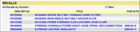

Acts fuel starved (intermittent) when warmed up. In 2 to 3 weeks time, car has stalled at idle (3 different times), and would crank normally but not start 5 different times. In all cases car was warmed up. Switched fuel pump relay w rear fog relay and started 5 times - no problem. Yesterday, went to work ( half-hour, in traffic) no problem. Stalled in fast food line, at idle. Went back later- started. Help!
