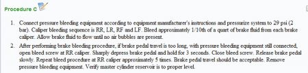

Try it this way if you can get a pressure bleeder...
https://www.2carpros.com/forum/automotive_pictures/62217_Bleeding_1.jpg
