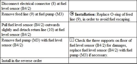

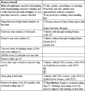

How do you replace the fuel pump on a 2002 C240?
