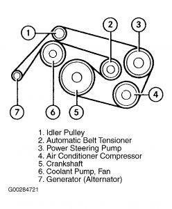

i need to remove my alternator bot dont know how to get the alternator belt to be slacken or loose so i can take it out,i dont know where the tennsioner is

hello and thanks for donating the diagram below will help you locate your vehicle's tensioner pulley. you will want to swivel this pulley and lock it in place with a drift to remove the alternator belt.
