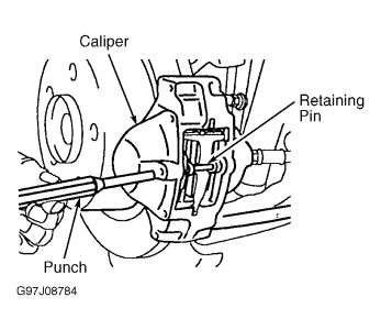

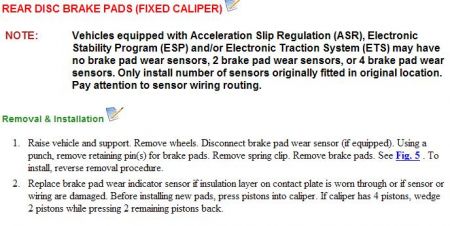

HOW TO REMOVE REAR BRAKE PADS TO CHECK CONDITION. I HAVE DONE FRONT PAD REPLACEMENT BUT REAR CALIPERS LOOK DIFFERENT. THANKS

Rear brake removal instructions as per text.
