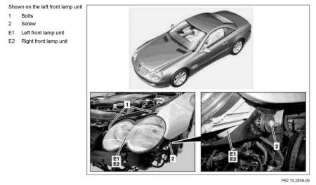

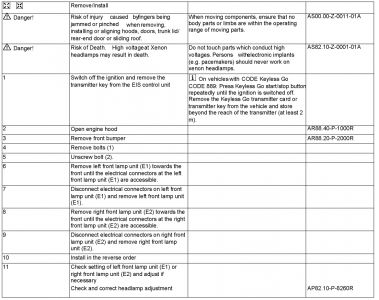

Step by step removal of passenger side headlight assembly?

Hi Edward Forbes, Welcome to 2carpros and TY for the donation
See below removal procedures
