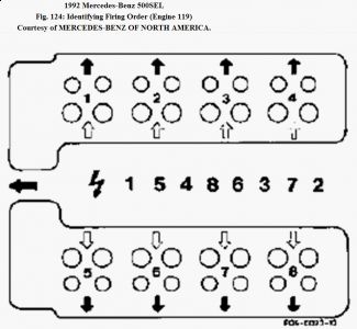

just put plugs back in can't remember the placement could you give me the distributor firing order for this motor you know what I want

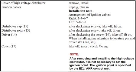

This should do it for you.
