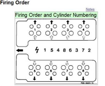

1992 Mercedes Benz 500sel for got the plug wireing
1992 MERCEDES BENZ 500SEL
TADUEL
Engine Mechanical problem
1992 Mercedes Benz 500sel Two Wheel Drive Automatic
just put new plugs in got lost on the plug wire hookup need something on distributor wiring need the distributor #########
Mar 12, 2010 at 8:05 PM
  • CAR REPAIR CONTRIBUTOR
  • 75,992 POSTS
Hi taduel,Welcome to 2carpros and TY for the donation.
https://images.2carpros.com/forum/automotive_pictures/12900_fom_1.jpg
