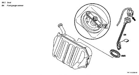

I PURCHASED A NEW FUEL SENDING UNIT. IT SEEMS SIMPLE TO REPLACE BUT HOW I CAN GET TO IT. CAN IT BE REACHED FROM THE TRUNK OR BY REMOVING THE REAR SEAT BACK? DOES THE REAR SEAT BACK PULL OUT? REMOVE THE REAR SEAT CUSHION FIRST? THANKS.

Hi Tank needs to be removed see diagram
https://images.2carpros.com/forum/automotive_pictures/198357_Graphic_267.jpg
Also need special tool called pin wrench. Thanks for donate
