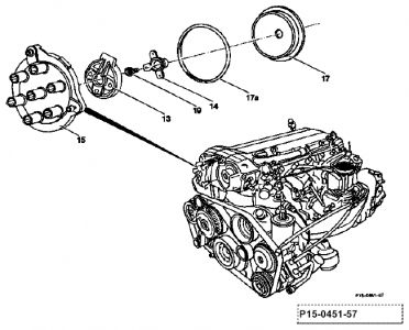

When i turn over the engine it sounds like i have all the spark plugs out,that fast no start sound??

Puull Dist cap off startengine does rotor spin?
https://images.2carpros.com/forum/automotive_pictures/198357_Graphic_488.jpg
If yes then timing chain has failed
