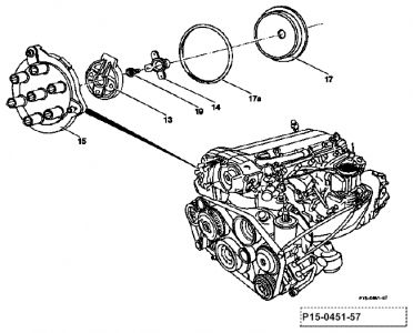

When I turn over the engine it sounds like I have all the spark plugs out, that fast no start sound?

Puull Dist cap off startengine does rotor spin?
If yes then timing chain has failed
