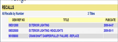

Hello - Also, it looks like you may have some recalls on your vehicle. The dealer may fix these for free. Please contact the dealer service department, give them the VIN number of your car and have them check on these to see if they apply to you.
https://images.2carpros.com/forum/automotive_pictures/248015_recall_6.jpg

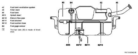

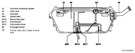

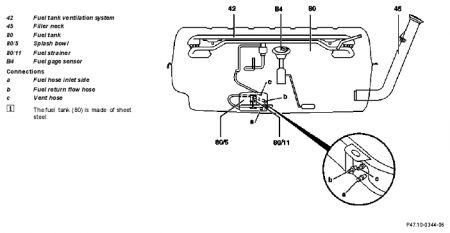

Thanks for replying so quickly. Is it likely that the nozzle gasket and guide sleeve are the only problem? I can't find a picture of the tank anywhere on the web. Do you have a diagram of the whole tank? I'm trying to figure out if the filler tube is likely damaged too. Any feedback?
Dec 20, 2009 at 10:37 PM
IMPALASS
  • CAR REPAIR CONTRIBUTOR
  • 3,112 POSTS
Hello - This is the best we have on the tank. Not sure which model you have, 210/220 or 210.2 or the 210.0 so I gave you all three. 210/220
https://images.2carpros.com/forum/automotive_pictures/248015_1_189.jpg
210.2
https://images.2carpros.com/forum/automotive_pictures/248015_2_125.jpg
210.0
https://images.2carpros.com/forum/automotive_pictures/248015_3_89.jpg
