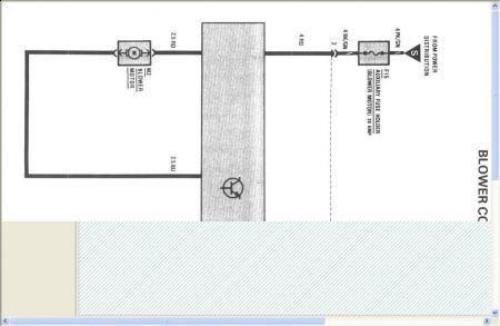

ATTN: rasmataz[img:86a410858f]http://www.2carpros.com/forum/automotive_pictures/455061_ac40_2_2.jpg[/img:86a410858f]
Thank you so much you have saved me a lot of time.
One more thing if you have it i have the control unit out of a 1996 it is the closest i can find without paying 500 to benz for a new one would you have the wireing scematic for the blower control for a 1996 benz?
thanks again Fred

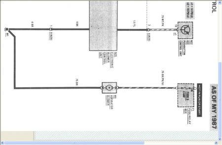

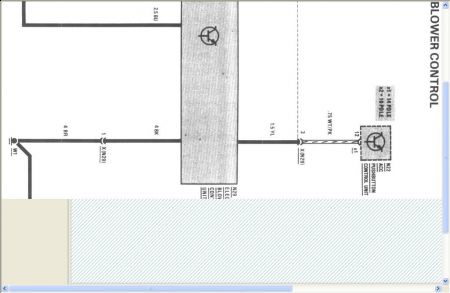

https://images.2carpros.com/forum/automotive_pictures/12900_blower1_7.jpg
https://images.2carpros.com/forum/automotive_pictures/12900_blower2_8.jpg
https://images.2carpros.com/forum/automotive_pictures/12900_blower3_1.jpg
https://images.2carpros.com/forum/automotive_pictures/12900_merc_1.jpg
Sent to your email also-Good Luck
