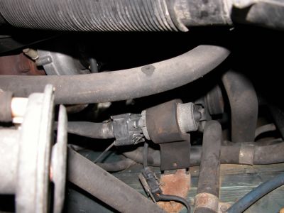

If I am correct, on the right front fender down by the flame there is a circulation Pump, it looks like this
https://www.2carpros.com/forum/automotive_pictures/307270_BMW_079_1.jpg

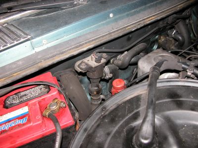

if that pump is not circulating when you turn the heater on you will have no heat. also there is a heater control the valve that looks like this next to the battery
https://www.2carpros.com/forum/automotive_pictures/307270_BMW_080_1.jpg
that valve is easy to check, just make sure the hoes going in is hot and the one coming out is hot, if the heater core is plugged the hoes on the left side of the engine coming out of the firewall will be cold. report back with your findings.

The control valve is working. When we drive the car there is no heat. When we shut the car off, wait a few seconds and turn the key on (we do not start the engine) there is heat. Once the car is started, it goes back to cool.

You failed to mention that the circulation pump was working. It is starting to sound like a plugged heater core, you can remove the line from a heater control valve and use your garden hose and try to blow out the heater core to see if you've got a circulation

I do not have the circulation pump as shown in the picture. This pump is on my 300d that we have but not the 300sd. I can get very hot air when the engine is off.
We are getting circulation but in my opinion it may be inadequate. I beileve ther is another type of valve under the valve at the firewall. It does NOT have any wires going to it but the hoses do. Will try to bypass this to see if flow increases.

This is on a 300sd. One of the photos you had posted was not like the 300sd, it was like the 300d.
