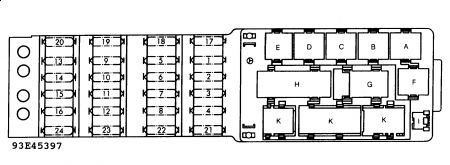

I have heard to do several things can you tell me is there a specific fuse for the heater blower? Mine does not blow anymore actually the whole thing does not work. If I turn the temperature gauge to cool temperature the cool air does come through chilled and only by delivery of the vent not through the blower.

Check fuse's 7, 8 and 12. It could be the actual bushes inside the blower motor are worn away and the motor need repairing or replacing.
https://www.2carpros.com/forum/automotive_pictures/266999_merc_5.jpg
