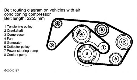

I was wondering if I could get the fand belt diagram please and thank you

Your vehicle should be equipped with electronic fans, not belt driven. your serpentine belt diagram is below..
