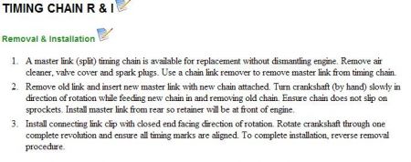

how can I change a timing chain on a 1987 mercedes benz

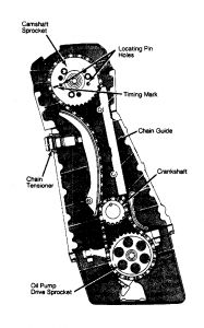

Hi there,
replace chain by joining new chain to the old one and with the plugs our rotate the engine slowly and feed the new chain on to the gears, see text.
