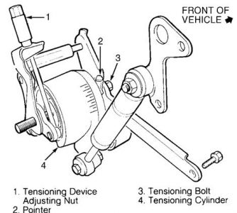

How do I replace the small shock absorber looking piece it is broken? I believe it is a belt damper.

Release the tension using nut (1)simply unbolt the top and bottom nuts of damper and remove and replace with new then re-tension the belt!!
Hope this helps
