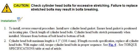

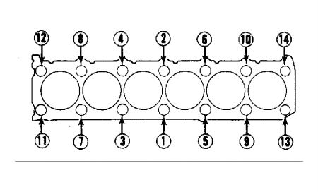

I would like to know the torque specification for the cylinder head bolt. Thanks in advance

Hi there,
Head torques.
1st stage 70Nm.
2nd stage 90 Deg
3rd stage 90 Deg[img]
