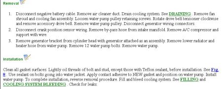

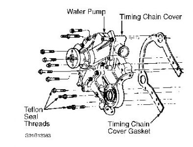

How do I replace the water pump on the 2001 B3000 Mazda Truck.
Monday, April 21st, 2008 AT 7:11 PM
SERVICE WRITER
MECHANIC
9,123 POSTS
+2
Monday, April 21st, 2008 AT 7:48 PM
