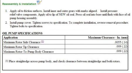

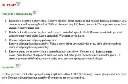

How to replace oil pump
Sunday, December 20th, 2009 AT 12:41 PM
BLUELIGHTNIN6
  • 16,542 POSTS
https://www.2carpros.com/forum/automotive_pictures/261618_Noname_1341.jpg
https://www.2carpros.com/forum/automotive_pictures/261618_Noname2_402.jpg
