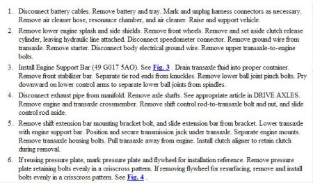

I was wanting to know if I had to drop the engine to install a new clutch or is there a easier way.

HI there,
You need to drop the transmission only, see text for basic instructions.

Thanks for the help, how long should it take if done properly(4-8 hours)?

Hi there, About 5 Hrs in a fully equipped work shop with a hoist, on the ground with jacks and stands ti may take a few more.
