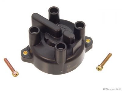

I didn't see a wire in the middle of the cap. Only four plug wires. Attached is a picture of what my dist. cap looks like.

The coil Must plug into that cap somehow, or it's built in. Like a GM. Give me a picture of the inside of the cap please. My manual does not tell location, but does give high tension resistance values for it.I know you have one!Look for a flat 7 wire connector.

Your right there is a flat connector on top of the distributor, that has a wire harness connected to it. Is the coil inside the distributor?
