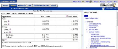

I need to know how to set time on the new distributer. I have a timing light but no manual.

Connect jumper wire between TEN and GND in the diagnostic connector and set timing -see below
