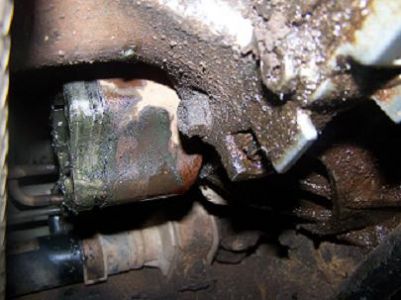

I am replacing the right CV joint and axle. Everything came out except the Cup mounted in the Trans. How do I get it out?

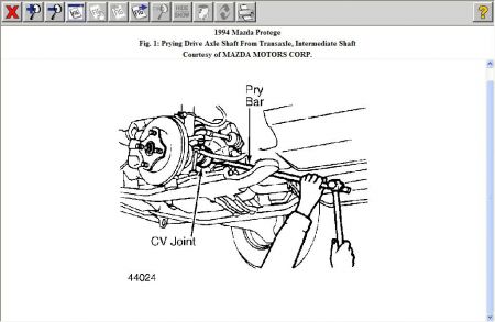

It is very easy. You need to get a big pry bar and pry from the transmission to the inside of the axle joint. It will just pop out. If it is hard then put 2 screwdrivers or pry bars on either side and have someone hit it with a hammer and it will pop right out.

https://www.2carpros.com/forum/automotive_pictures/12900_cv_joint_removal_1.jpg
