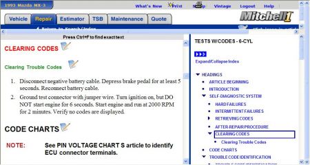

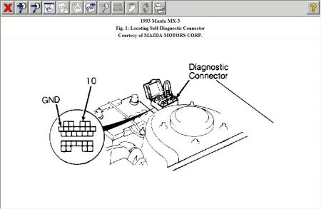

My MX-3 has had the Check engine light on for the last three years, engine runs fine, no idle problems or smoke of any type, in short no problems to report.

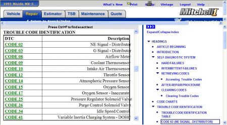

I will have to sell the car soon and I'd like to know the error code to fix the problem or clear the error codes. I know it got an ODB1 port next to the battery. What pins do I have to jump to read the flashes. If its like the MX-6 first flashes should be the 10 digits followed by the single digits.
Next do you have a code chart?
Finally how do I clear the codes?
Thanks all.

There you go Sir and Good Luck Jumper TEN to GND same as MX6 -see below
https://images.2carpros.com/forum/automotive_pictures/12900_TEN_to_GND_1.jpg
https://images.2carpros.com/forum/automotive_pictures/12900_code_nos_1.jpg
https://images.2carpros.com/forum/automotive_pictures/12900_clearing_codes_1.jpg
