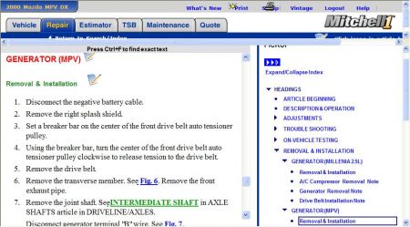

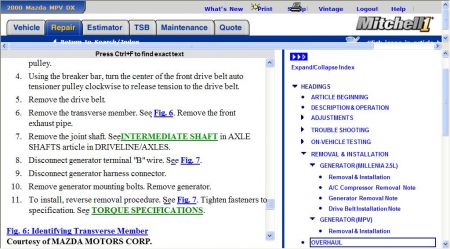

How do you remove the alternator from the engine compartment.
Thursday, May 1st, 2008 AT 1:04 PM
MECHANIC
75,992 POSTS
See procedures below
