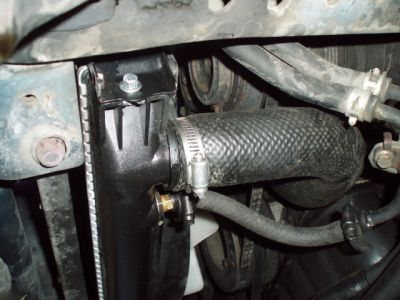

1995 Mazda MPV only warm air
TRUCDAO
MEMBER
1995 MAZDA MPV
6 CYL
4WD
AUTOMATIC
140,000 MILES
"Only warm air blow out and over heat after 30 minutes or more"
REPLACED:
1. New Radiator
2. New High tempeture Thermotas
3. New water pump
FOUNDED:
On radiator the top hose is HOT but the bottom hose is COLD

Was this condition present before repairs? Have you taken coolant temp? Gague reading?

Same problem as before the repair
However first day after repair, seem bottom and top hose is warm, but after a week now bottom hose is cold top is hot

It maybe new thermo has failed. When it first starts up top hose cool then warms? How do heater feel?
What is coolant temp in Rad?

Top hose cool then warm at first start. Heater cool then just create a litter warm. Tempeture at the mid of metter

Try three different name brand of Thermotas. The bottom hose has same issue

Does fan free wheel?

Yes, fan ran fine
