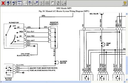

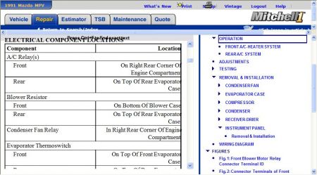

Hi evryone I have a 91 madza mpv which the Blower stop working #1 where is it located #2 has anyone had this problem need help it HOT out here.
Thanks
Thursday, August 7th, 2008 AT 8:48 PM
MECHANIC
75,992 POSTS
Could be the blower switch/blower motor resistor and blower motor itself-see below
