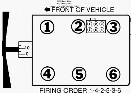

Hello, I am currently trying to change my spark plug wires and like an idiot I removed them all at once. I know. Anyways I need to know which plug goes where. I have the firing pattern from the manual but it really doesent tell me where to connect to the distributor. I just need a simple diagram I guess (for dummies if you will). I appreiciate any assistance.

https://www.2carpros.com/forum/automotive_pictures/62217_b3000_1.jpg

Hello, thank you so much for you're quick response. Do I just connect 1 to 1, 2 to 2, and so on? If so I have it this way now and the engine will not fire, it will turn but will not fire. I do have to say that I may have had it connected the wrong way and tried to start the engine, would this have cause another problem? Thank you for you're help.

You do connect the wires from the coil pack to the corresponding cylinders. Check your fuse panel for any blown fuses. Then perform a spark test and fuel test. The engine needs three things to run, Spark at all plugs, gas to all cylinders, and compression in all cylinders, tho an engine may run lacking one in one cylinder, it won't run very well!

I show a coils pack for your year, and if you look on the coil pack in the diagram, it shows what number cylinder each terminal connects to? This is what shops use to attach the plug wires.

I had the wires connected as shown in you're diagram, 1 to 1, 2 to 2 ext and this is wrong. The engine did fire but it was only running on maybe 4 to 5 cylinders. Just for example the number 3 on the coil pack in you're diagram is supposed to connect to the number 1 cylinder.

Here are the spark plug wire connections for a 2006 Mazda B3000. These connections are based on Merlins diagram above.
Coil pack# 1 to Cylinder 3
2 to Cylinder 2
3 to Cylinder 1
4 to Cylinder 5
5 to Cylinder 4
6 to Cylinder 6
I hope this helps someone.

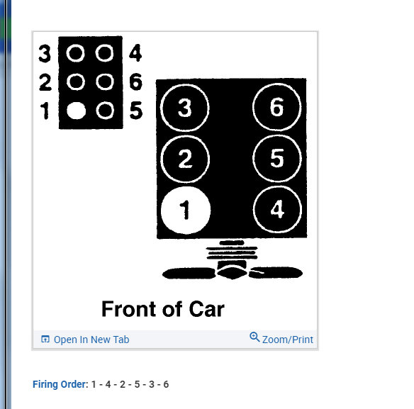

Firing order is below.
Firing order: 1-4-2-5-3-6
https://www.2carpros.com/forum/automotive_pictures/261618_0900c1528009156b_2.jpg
What belt are you replacing? Timing or drive belt?

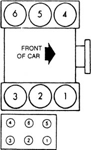

Changing out spark plugs and it runs horrible and has no power and popping. Figured the spark plug wires aren't in the right order. Need help which wire goes where to which corresponding cylinder.

I attached the firing order and cylinder layout for your review. Let us know if you need more info. Check out the diagrams (Below). Please let us know if you need anything else to get the problem fixed.
