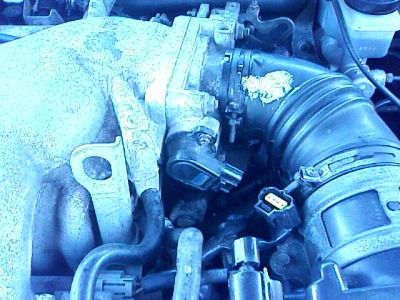

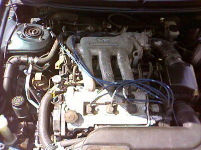

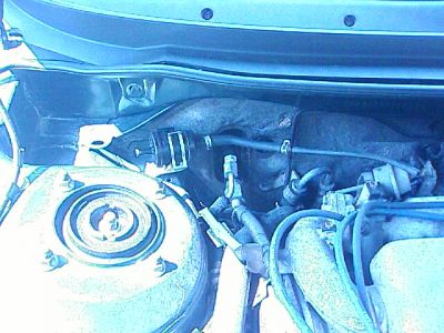

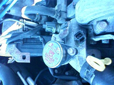

Hi I bought this car a few months ago and the RPM had bounced since I told my uncle about it. He has some knowledge about cars so all he did was unplugged the TPS and nothing else. There are some parts missing around the engine when I bought it and I got some pics to show u. I went to this shop to see what can be done and the guys gave me some codes after they checked it up. Here are the codes #12 TPS #15 left oxygen sensor circuit #17 front feed system #23 right oxygen sensor circuit #24 right feed back system #25 pressure regulator selenoid. So I went out to auto parts stores and the guys all said something diffrent. They said i need a crankshaft position sensor and few of the codes I showed were wrong. I just want to know which parts I need to fix it cause its killing me on the gas. I hope the pics help. . .

Are you driving around with the TPS unplugged? Picture # four looks like an ECT that has no plug, and what is the spot on the air tube? ALL connectors ahould be plagged back in to get any meaningful codes!
