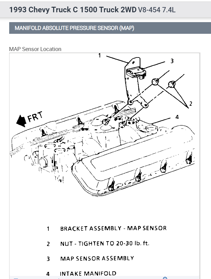

I am looking for a diagram of the 1993 7.4l 454 with sensor locations. I believe I have a bad MAP sensor.

Yes, the MAP sensor is on the passenger's side of the engine next to the air cleaner. Check out the images (below). Please let us know if you need anything else to get the problem fixed.
